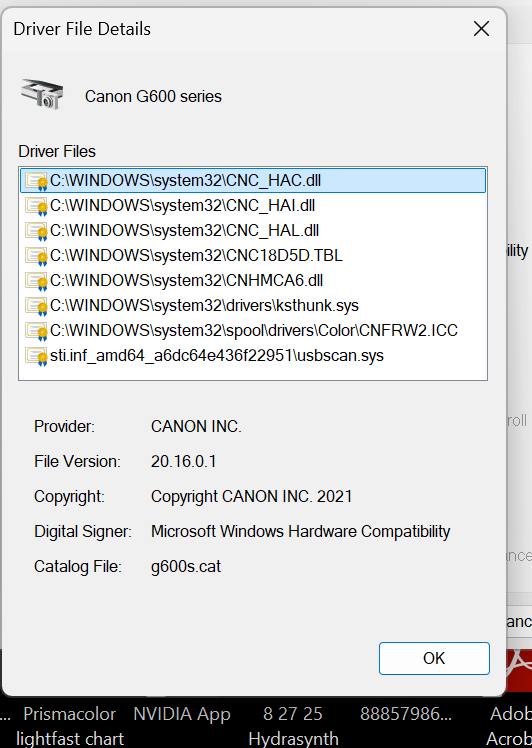

04-19-2026 03:42 PM - edited 04-19-2026 03:58 PM
When I bought the computer it said windows 11 but it always shows up as 10 . I am using USB and I am in the US. No problem until I woke up this morning. When I pull up the drivers for the printer...all of these show up. Is the right one on the list??
