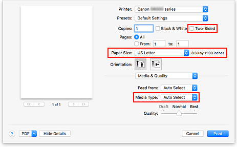

10-13-2020 09:29 AM - edited 10-13-2020 09:29 AM
Hi jlmaitri,
The paper settings could be the cause of the issue that you are experiencing.
With the item that you wish to print open, please click on File and Print.
In the Print window, please click the "Show Details" button at the bottom.
Choose "Media & Quality" from the drop down box and then below that, please select your paper from the Media Type box.

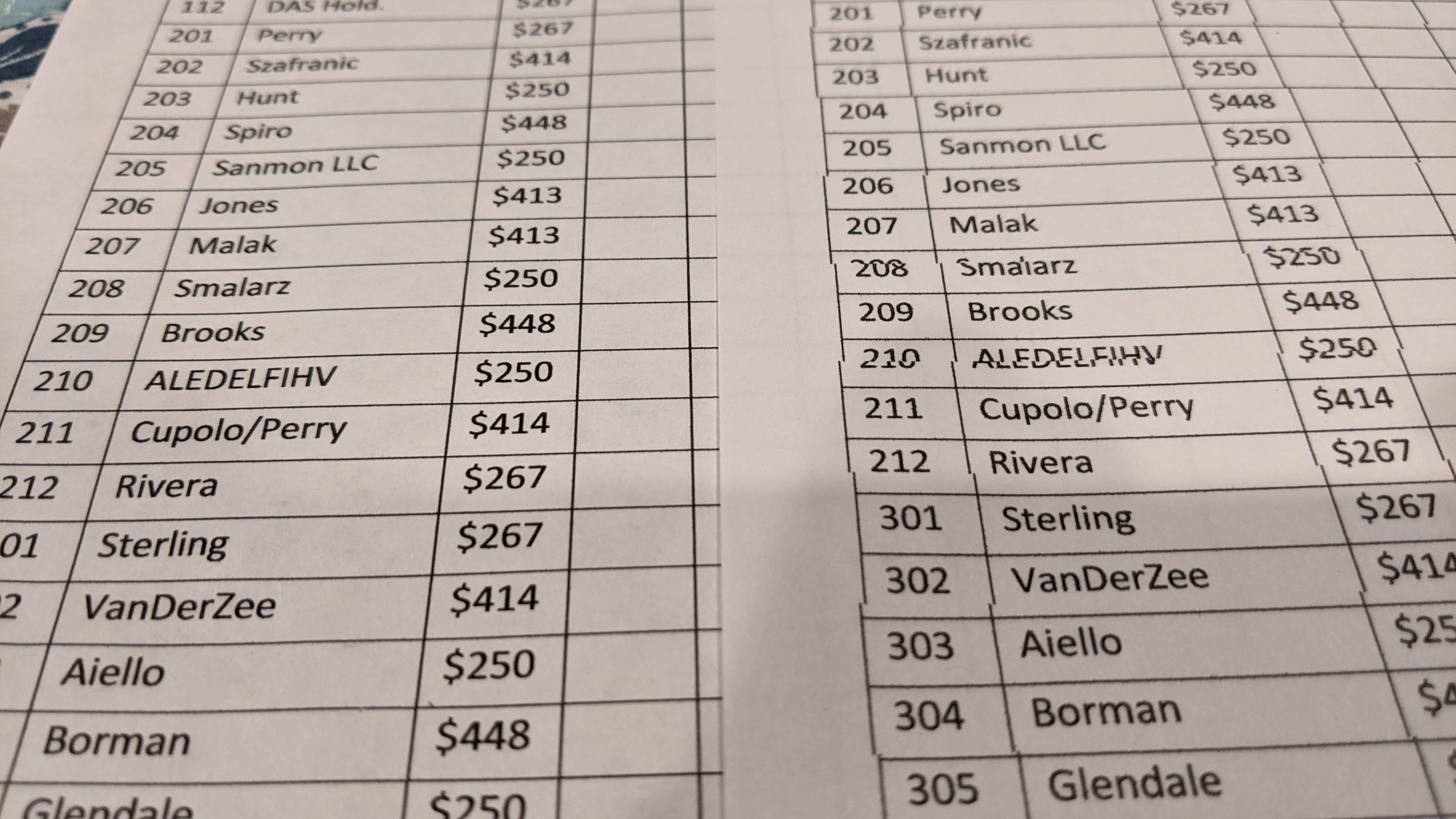

11-02-2020 04:03 PM
I am having an issue with my Pixma G6020 printing as well. When I print in Standard or Economy mode, the printing is out of alignment. However, if I print in High quality mode it is fine. It seems like the speed at which the printer head moves is having an effect. See the attached image for an example. On the right is the Standard print and on the left is the high quality print. I have tried the head alignment proceedure several times, but I get the same results.
12-02-2020 04:20 PM
Hi ColonialManor,
Please clean the encoder/timing strip in your PIXMA G6020. To do this, please use the steps provided on this page:
https://support.usa.canon.com/kb/index?page=content&id=ART177609
If you continue to have difficulties, please contact our support group using the following link:
https://mycanon.usa.canon.com
12-06-2020 05:48 PM
Thank you so much for this suggestion. It seems to have done the trick and my printing is coming out much better.
