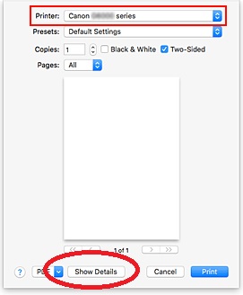

Please click the magnifying glass in the upper right hand corner on your computer. In the Search box, please type TEXTEDIT and then open that application.
In the window that appears, please type a few words and then click on File and then Print.
In the Print Options window, at the bottom, if you see "Show Details", please click that button. If you see "Hide Details", please continue.
In the middle of the print menu, click the TextEdit drop down box and select Media & Quality.
From the Feed From drop down, please select "Main tray" and then please attempt to print.
