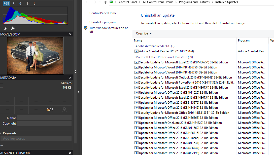

Other possible option: In addition to the Uninstall updates option, you can also try system restore and revert the system to the point in time prior to the updates. Windows does this automatically.
Example below:
