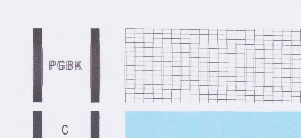

I have a problem mentioned in other posts on other printers - but unfortunatey no definite solution. The test print output shows the problem
I have tried cleaning, deep cleaning, aligning, updating drivers and removing the printhead to clean it outside the printer. A possible other solution is cleaning the encoder film.
I can't see how this could be the problem as the print deformation consistant across the page. The encoder runs all along the page also - so the problem with it would have to be the same along its full length? I may be wrong so I will clean it to see if it changes anything. The problem in doing this is access to it. How do I remove some/all of the printer panels to gain access? Any assistance will be appreciated.
I can't understand how the above pattern deviation is so regular? I assume there are 2 printing passes to generate the output. It looks as if there is a progressive delay in pushing the ink out of the head towards the centre of the pattern. This would account for the pattern generated.  If it was a "simple" print blockage/restriction I can't understand how it is so uniform?
Any feedback / advice etc. would be welcomed.
Trevor

My MG7120 has the same problem, I was sure it was the printhead so I ordered a new one, but to my great disappointment the problem didn't go away, I used all new ink tanks as well.  Might be time for a new brand, and I've used Canons for something like 10 years now, ever since I got my first printer.

I brought up the exact same issue recently on this forum, see http://community.usa.canon.com/t5/Printer-Multifunction-Support/Canon-MG5650-Page-Black-Text-Double-...
This issue only affects when using Page Black ink and when the printer is forced to photo mode and so uses Photo Black ink, the text is sharp - so it's not the encoder strip being 'dirty' otherwise all printing would be affected be text, graphics or photos.
I am wondering it's because I am using non-oem ink cartridges, there is a random counter being triggered by their use, and when this runs down it triggers the print engine software in the printer to mess up the printing deliberately - a bit like the recent Volkswagen issue where the engine management software determines that the car is undergoing an emissions test and so changes the engine characteristic to pass that test! Canon wants you to buy another printer.
Think about it, it affects many types of printer, using a different number of cartridges, so the print heads are different and so therefore the drive electronics all showing the same issue on paper. As other people have said replacing the print head does not make the issue go away.

If it is as you think could be a way to do for example an hard reset or a real factory reset so the printer can restart to print well. On my experience, the first time that I changed the printhead,the printer restart to print well for a very short period,Unfortunately I don't use so much the printer and when I retried after I don't remember well but could be one week the problem restart to be present,so I tried to buy again a new printhead and all new cartridge to be sure but unfortunately the problem isn't solved and now the printer just in the pgbk doesn't print well.
I'll join this club with my MG5450.
My case started with occasional B200 errors that interrupted print jobs. Tried every trick I could find - including thorough cleaning of the print head. No help. So I concluded the print head must be faulty. It probably gets too hot after some printing and then B200 occurs.
Then I ordered a new print head from China -> black PGBK distortion from the beginning. Color printing works fine. Tried cleanings & alignments. No help. Then I temporarily put the old print head back: no distortion. So I concluded my new print head must be faulty. Now this thread gives me hope/second thoughts.
