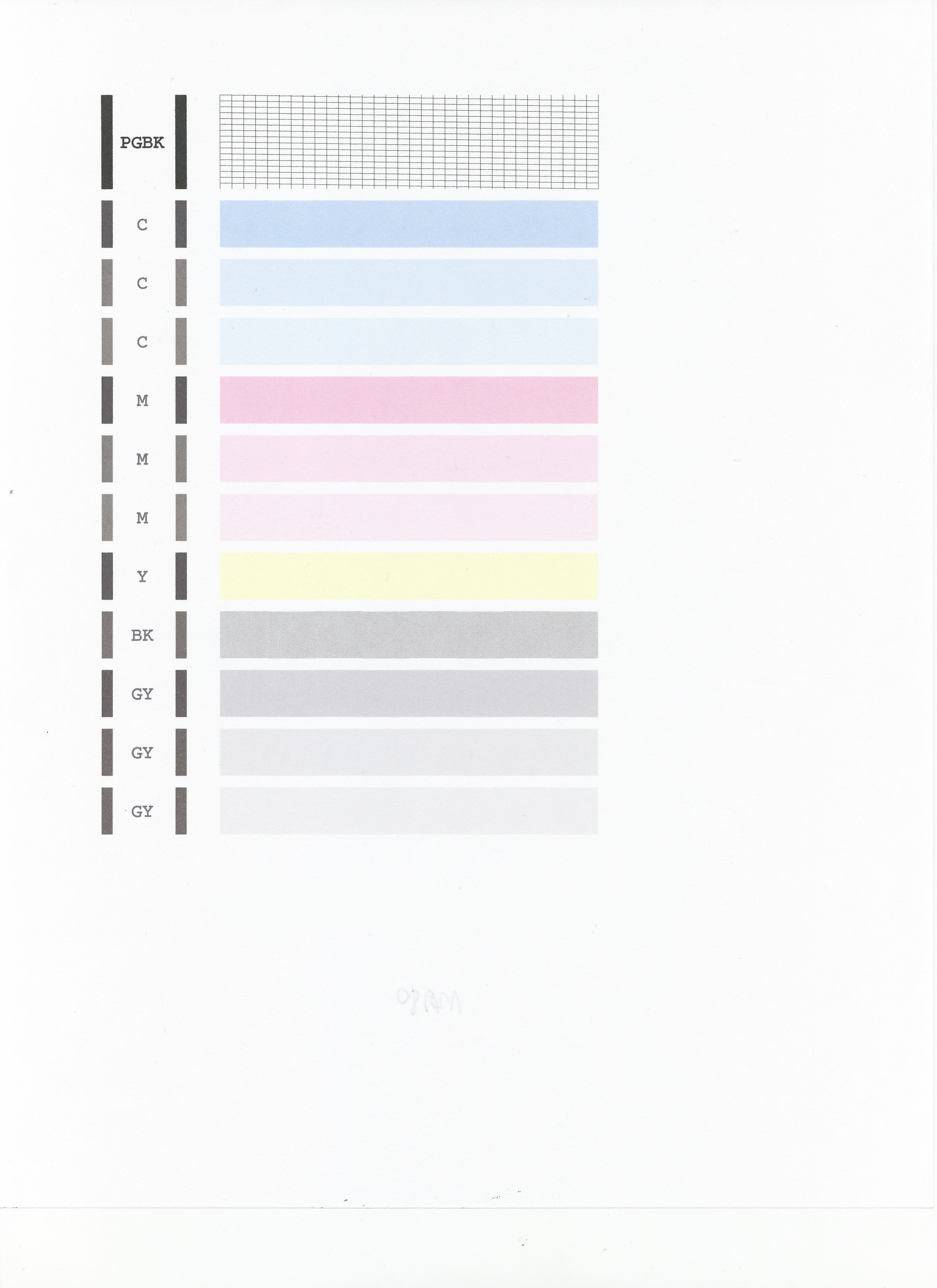

After a few cleanings, please print a Nozzle Check. Please compare your Nozzle Check with the example below:
If the black grid does not print after performing multiple printhead cleanings, your PIXMA MG6220 would require service.
