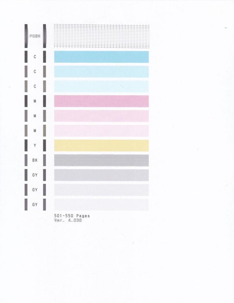

Hi! I have a Canon MG5620 printer that started printing distorted in PGBK only. The vertical lines print as vertical elipses between the second horizontal line at the bottom and the top of the graph display on the "nozzle test" page. My problem is, can this be fixed or is it time to shop for a new printer. I can post the print if required. Thanks for the guidance!

What do you mean by "the nozzle check pattern is a maintenance function which is stored in the printer's memory?" The PGBK image prints but ALL the vertical lines are ellipses. Also the number of pages and version that prints at the end of the nozzle printout are double printed on top of each other. The text printed in the column by the C/M/Y/BK/GY colors is perfect. It is only an issue with the PGBK printing, and ONLY VERTICAL printing.

This is caused by warping of the PGBK printhead which is supposedly due to overheating of the printhead. I have replaced the printhead when this happens and had the new printhead go bad in just a few days. Don't know if this is because of the printhead heater getting too hot or the heads not cooling because of non Canon ink or printing too many pages without stopping. Supposedly turning on the quiet setting helps by making the printer print more slowly. There are ways to make the printer use the dye black ink to print text but that has to be more expensive. (If there was a printer from another company that would print DVDs I'd switch but no luck at present.
