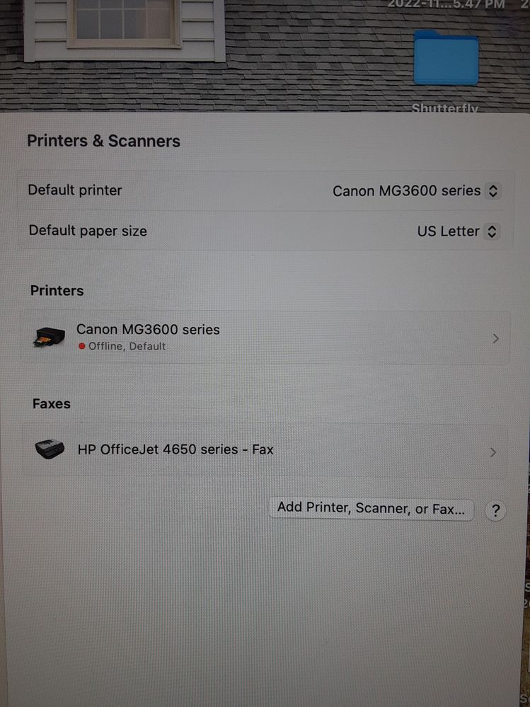

The first time, it printed and scanned fine. I leave my family member's house and she attempts to print and it says the the printer status is idle and the printer will not print.
I went back and powered down the printer, unplugged the power cable and the USB out of the back of the printer, waited about 60 sec. Replugged everything. It still says idle. I then swopped USB ports on the back of the iMac and then it recognized the printer and I was able to print. I printed and scanned and everything worked. My family member later contacts me and says it is "not connected in the print monitor and will not print. All ports are working on the back of the iMac. All devices are detected so I don't anticipate that the Mac is defective. I can get it to work when I am at the house, but when I leave it seems to go on the fritz. Is there a standby mode that cause the Mac to not see? Is the printer fighting between between USB or wireless? I never set up the wireless because the network can be unreliable. I just want the printer hooked up to the USB cable.
Thanks for your help.

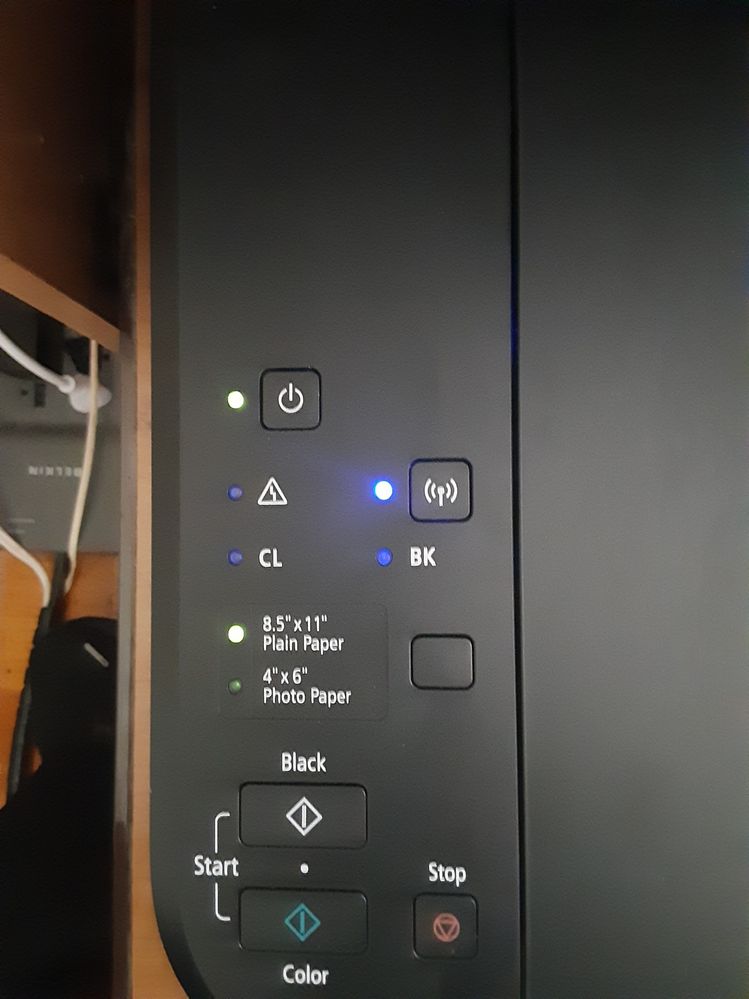

The problem is that the downsizing from the USB to USBC is causing the problem. The USB C is underpowered for the printer and therefore fails. Canon is supposedly working with Apple to develop a solution due to the change in technology. Until that is fixed, you have to use a wireless connection. Canon recommended connecting to the printer through the iMac WiFi. Here is a link to the details to set up this up.
https://support.usa.canon.com/kb/index?page=content&locale=en_US&id=ART162671
Read the complete link because it requires you to enter a password. Record your serial number before you perform this function. That is the password.
Press and hold Wi-Fi button and release it when ON lamp flashes.
Press Color button (let off), Black button (let off), and then Wi-Fi button (let off) in this order. (user advice: don't press all of these at the same time)
The ON lamp changed from flashing to lit, the Wi-Fi lamp lights up, and then the wireless LAN is enabled.
