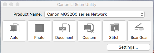

change the settings using dropdown to select as in screenshot. that will work if you have enabled wireless connection. i had the same problem as previous posters and discovered it by chance 🙂
hope this helps someone in future.

Just bought this scanner second hand - this tip helped me a ton! Thanks loads.
