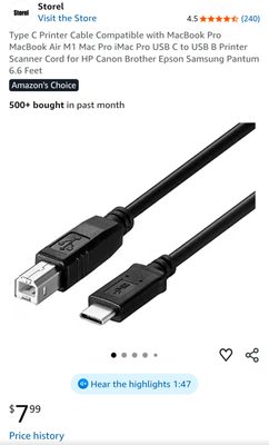

If not, I suspect the cable or adapter you are using is not compatible with your printer or your Mac. In actuality they're not universally compatible or interchangeable.
It might be worth your while to get cable that does not utilize an adapter. Something like this would work.
If the issue turns out to be related to device connectivity this should get you on your way. If you continue to have issues, please let us know.

Thanks ShadowSports, I was hoping that printer cables adhered to a standard. I was worried about the printer not being supported well through the USB dongle. I'll try a more direct connection.
Nothing is asking me to accept a USB connection anywhere. There just seems to be no communication over USB, but I was not sure if that was being blocked by software or hardware. You're suggesting most likely hardware, so let me see if this works. I have ordered a cable, which should be here tomorrow.
11-04-2025 06:31 PM
I also think the problem is caused by the USB cable you tried to use. USB-B (Printer end) to USB-C is the only way to go.

I have the cable and have installed it. I can at least see the printer when I attempt to add a printer. However, it appears offline and does not print a test page when printed from the Canon setup assistant software.

OK, got it to work.... finally.
Purged all old Canon install of software. Turned off Bit Defender and Little Snitch. Re-installed the drivers. That finally worked! It was definitely not easy, but much easier than with a cable that wasn't compatible. I was able to plug the USB-C into the back of my Studio Display Monitor, in which I connect my laptop, and that worked. So it is not directly connected to my laptop, but going through my Monitor. Thanks for everyone's advice. It was impactful.
