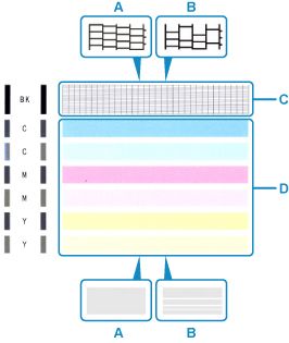

Please perform a test of your PIXMA TS6420. Load a sheet of plain paper and then follow these steps:
1. Press the OK button one time.
2. Select Maintenance and press OK.
3. Select Nozzle Check and press OK.
4. Select Yes and press OK.
A test page will print.
Does your test page match the example provided below?
