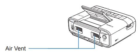

Also, please clean the air vents of your SELPHY CP1300 with a soft dry cloth.
