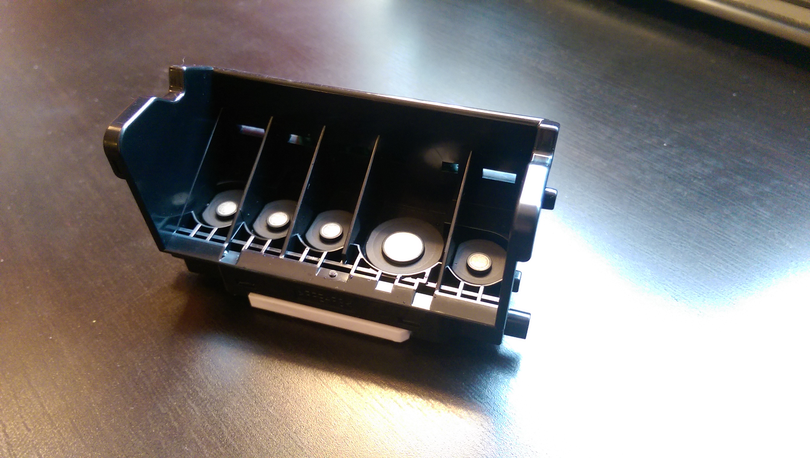

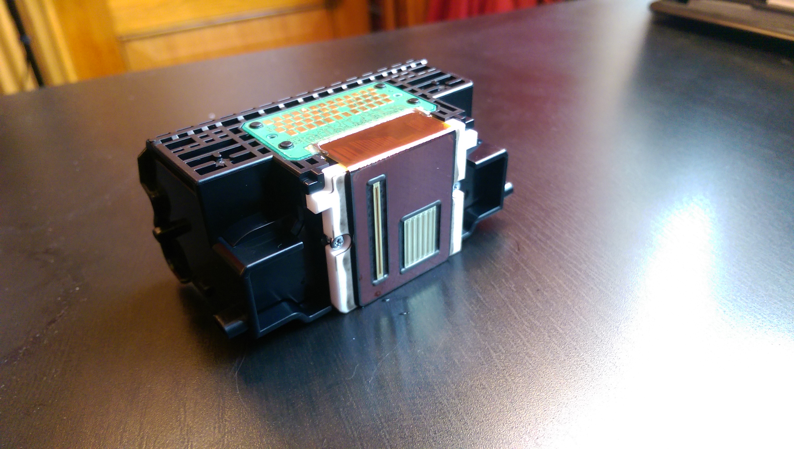

Hello, I'm having some troubles with my printer Canon pixma MX 715.
I had bought it around 3 years ago, it was working fine until I left the unit alone in disuse for approx 4 months. When I went to use it again, ofcourse my nozzles were clogged and I recieved the printhead error message.
I bought a new printhead QY6 - 0080, for £60, approx $90-100. I didnt have any other errors other than to replace the printhead. Once i removed and replaced the old printhead with the new one, it all seemed to be registering fine.
I bought 2 new sets of ink (XL) - I went to run a 'nozzle check' and the machines starts moving. The noises of the printhead moving back and forth indicate something is happening; However as it was printing, blank pages came out, with no traces of ink on the paper.
I ran 'clean' and tried again, still nothing, even though the ink levels in the cartridges was dropping.
I than tried 'deep clean', twice, still nothing printed on the pages (With brand new sealed printhead and cartridges)
I did a hard reset - following a video on youtube (hold down cancel button, then press & hold 'on', then press cancel buttons five times - made some noises, still nothing being printed)
Ran 'reset' option via printer LCD, still nothing
I took out the printhead and inks, and did a nozzle clean on the printhead (ink seems to travel through printhead fine as alot of ink came when soaking printhead in water) reinserted clean and dried printhead and inserted inks - still nothing.
Ran 'auto align' to see if it is something mechanical - 'auto align' error display on LCD - just says 'refer to manual - :('
ran manual align - operation didnt come up with any errors, but still nothing printed on the paper, still blank.
uninstalled, cleaned registry (ccleaner) and reinstalled program (win 10 x64) - still nothing being printed although communicating via lan and wifi fine.
Restarted 'printer spooling' in 'services.msc', restarted, stopped and started. Still nothing being printed.
Tried to run a photocopy, still nothing printed.
Ran 'clean' and 'deep clean' again with intervals as to not overheat the printhead - still nothing, all inks are now emptied (2 XL sets)
Cleaned 'waste ink' sponges seated on the right in the rubber gaskets - still nothing.
I AM BEWILDERED!!!!!!!!!!!!!!!!!!!!!!!!!!!!!!!!!!!!!!!!!!!!!!!!!!!
Any suggestions Canon?
Thanks!
