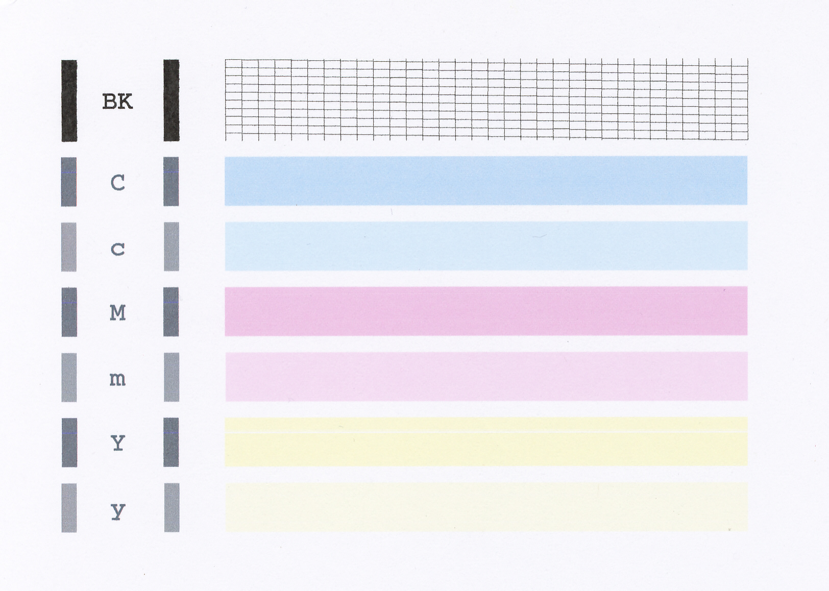

A test page should be printed from your PIXMA MP495. The nozzle check pattern shows if each print head nozzle is operating properly:
1. Ensure that the printer is powered on and the LED displays a 1.
2. Open the paper output tray.
3. Load a sheet Letter-sized plain paper in the Auto Sheet Feeder.
4. Press the <Maintenance> button to display [A]. The Maintenance button is the button on the Operator's panel which has the wrench and screwdriver label above it.
5. Press the Black Start button. The machine will print a nozzle check pattern. Please compare the test page that you printed with the one that has been attached to the bottom of this post.
If the test page does not match the example attached to this email, printhead cleanings should be performed. To do this, please follow these steps:
2. Press the <Maintenance> button once to display [H].
3. Press the Black Start button. The cleaning will commence.
After performing a few cleanings, please print another test page.
