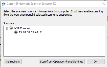

I was able to work around the auto install utitlity (mp68-win-mx920-1_00-ejs.exe).
Here's what I did:
Confirm that you have the Printer and Fax drivers installed.
I was able to get it to work using Windows' generic scanner driver, but had to install the Scanner Network Tool manually to work with the printer since the driver is not compatible. I did have the imaging device show up in Device Manager, but with a generic driver.
On the driver package download you get from Cannon's website (mp68-win-mx920-1_00-ejs.exe). Change the file extension from ".exe" to ".zip" so you can access file contents (you might have to enable this in folder view options if it doesn't show the file extension, so web search enable file name extension and it should walk you through it)
will be changed to
confirm you want to change the file type, you can always change it back.
Decompress the contents.
Inside the decrompessed folder you will open the root folder to get the contents
You will have to execute the scanner tools manually. The Cannon Driver isn't compatible with Win 10 Pro x64 UEFI Secure Boot. Cannon will have to fix that.
I don't know if order makes a difference, but if you get an error that states another driver isn't installed (I did just can't remember which step) just move on to the next and come back to it.
From the root folder
Locate and open folder "LANUTIL"
Locate and open folder "NWTOOL"
Execute "SETUP.exe"
Return to root folder
Locate and open folder "SELECTOR"
Execute "SETUP.exe"
Locate and open folder "SCNUTIL"
Locate and open folder "ScanUtility"
Execute SETUP.exe
Locate and open folder "Twain"
Execute "SETUP64.exe"
Reboot computer (not sure if necessary just old habit)
You should now see a program called Cannon IJ Network Scanner Selector EX (in apps and in task bar on bottom right of screen).
If you open this up and it recognizes an IP address for your printer, you are good to go. I was able to scan from the scanner (starting at the scanner).
Best I can think of until Cannon fixes the driver. But I scan alot and needed it to work without reinstalling Win 8.1 Pro x64/
Help this helps.
