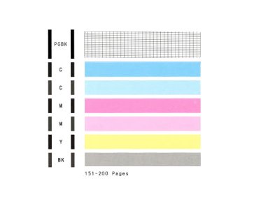

A test of your PIXMA MG5750 should be performed. This will tell us if the printer is working correctly. To do this, please load letter-sized paper in the PIXMA MG5750 and follow these steps:
1. Select SETUP from the HOME screen of your PIXMA MG5750.
2. Select Maintenance and press <OK>.
3. Select Print nozzle check pattern and press <OK>.
4. Select Yes and press <OK>.
The Nozzle Check will print. Please compare your printout to the example that has been attached to this email. If they differ, please perform a few printhead cleanings.
To perform cleanings, please follow these steps:
3. Select Cleaning and press <OK>.
5. Select Yes and press <OK>.
After a few cleanings, please print another Nozzle Check.
