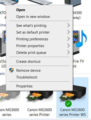

I am confused.  I don't see the "start scan option when I right click on my printer.
Is this because I have a different printer?
