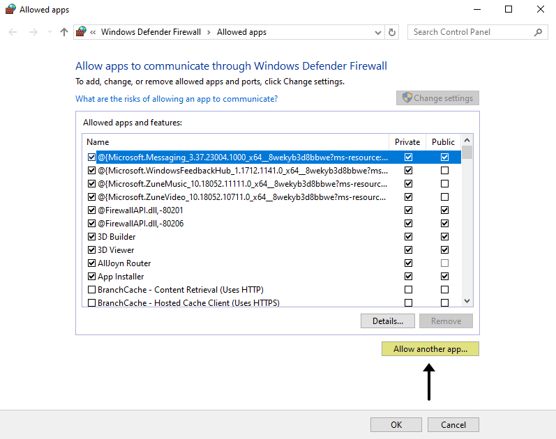

Hey,
Follow these steps please :
> In the search bar of the Windows Taskbar type : Firewall
> Click on "Allow an app through Windows Firewall"
> Click on "Change settings" button
> Click on "Allow another app..." button
> Click on "Browse..." button
> Browse to this path : C:\Program Files (x86)\Canon\EOS Utility\ and choose "EOSUPNPSV.exe" file
> Check both "Private" and "Public" for the "Canon EOS UPNP Detector"
> Click on "Ok"
Best
Lynx
I just registered this account to give you command. Finally someone can tell how to change the firewall setting by hand.
thank you!
