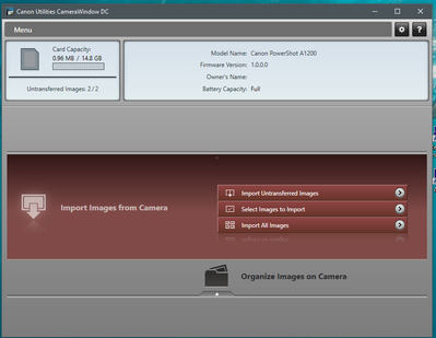

@shadowsports,
That Application CameraWindow is not working with latest Windows 11 and my PowerShot A1200. 🤷‍♂️
I don't know if it ever worked with this model of Camera in the past, I guess I can try with Windows 10. 😂
Cannot detect Camera even when the Camera is clearly there in File Explorer. 🤷‍♂️🤬
Same Canon Utility CameraWindow DC has no problem with Windows 10 and the same Camera Canon PowerShot A1200.
So much for compatibility. 🤣🤬
There is also a newer version of Canon CameraWindow DC which I tried.
CameraWindow DC 8.10.9b for Windows (hk.canon)
It works fine with Windows 10 but fails to connect to the Camera in Windows 11 like the older version. Basically, useless because Canon never updated the utility for Windows 11. 🤣🤣🤷‍♂️
