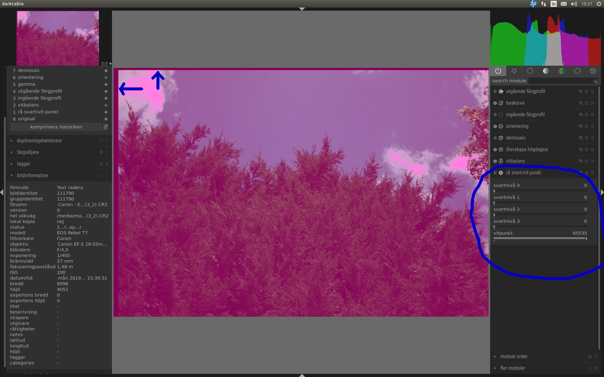

Pink means that the black level isn't correct. For example older RawTherapee or older darktable versions that  haven't got the raw support for a camera model yet. T7 got raw support last year.
I have attached print screens from RawTherapee, darktable and one pink one from darktable with the black level put to zero. In the pink one you will also see the optical black area that raw converters normally don't show you.
Optical black areas can be used to remove the random banding issue from EOS R.

Hello Peter,
I feel really dumb right now. I went back to my download folder to see which version of raw Therapee I had gotten, and it was 2.41 (!). Not sue how that happened, but I did download 5.8, and all is now much better. One thing I did notice, is that the same file opened in RT has a lot of what I assume to be noise specles (multi-colored pixels scattered all over the image) that I do not see in DPP4. I turned off de-noising, sharp mask, etc. and the difference is still there. I also saw the same "noise" (or whatever it is) opening the file in PhotoscapeX.

As you can see, the image with noise is brighter and sharper. Those things increase the visible noise. Probably you use the default settings in RawTherapee that increases the contrast. I find darktable easier to handle.
I use all three raw converters. darktable, RawTherapee and DPP4. DPP4 doesn't have support for Linux so I need to use a VirtualBox. I really like the lens correction, but the lens correction in DPP4 is only for Canon lenses. RawTherapee and darktable use Lensfun as lens correction database. It means you can add any lens.
If I shoot raw and want to have the exported jpg to look like jpg straight out of the camera, but with higher image quality, DPP4 is easiest to use.
With both RawTherapee and darktable it is possible to remove the maze pattern from EOS R. It was not possible with DPP4 or Lightroom in December 2019. Perhaps Adobe and Canon have solved the problem in March 2020?
Different raw converters, different strengths and weaknesses.
