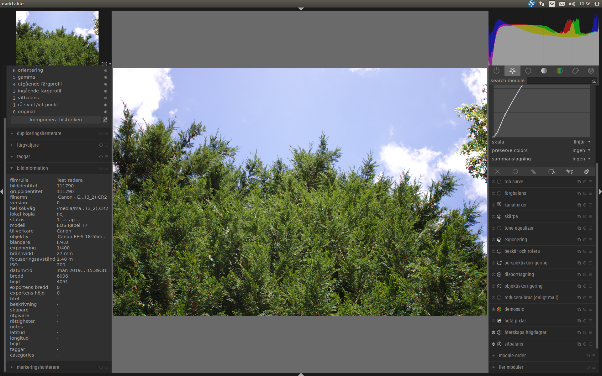

03-13-2020 06:15 AM - edited 03-13-2020 06:24 AM
@davetelling wrote:
@Peter wrote:
RawTherapee 5.8 works and so does darktable. UFRaw hasn't been updated for years.I did try Raw Therapee, and it did the same as all the other "free" apps - pink everywhere. I am going to try the Canon DPP and see how that works.
Pink means that the black level isn't correct. For example older RawTherapee or older darktable versions that haven't got the raw support for a camera model yet. T7 got raw support last year.
I have attached print screens from RawTherapee, darktable and one pink one from darktable with the black level put to zero. In the pink one you will also see the optical black area that raw converters normally don't show you.
Optical black areas can be used to remove the random banding issue from EOS R.
