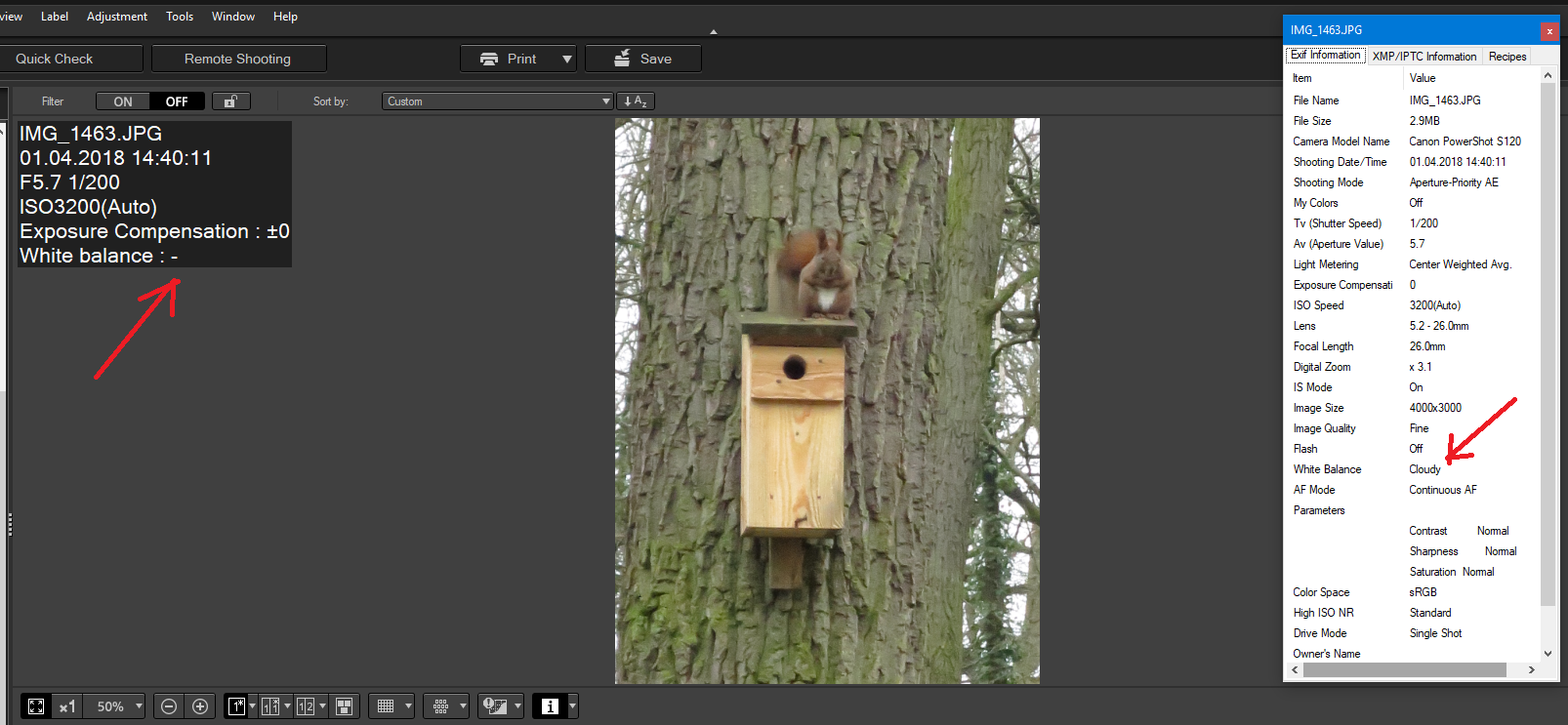

I have DPP 4.8.20.0
Screenshot shows what I wrote in subject.
04-07-2018 04:24 PM
Technically, both displays are correct because your image appears to have been a photo saved as JPEG in the camera.
The right hand info display is showing you the camera settings used to create the image. The left side is trying to indicate that a JPEG has no actual WB setting. The only WB setting that applies to a JPEG is “As Shot”, which in your case is “Cloudy”.

A JPEG does not really have WB data. The WB setting is baked into the image when it was adjusted, which is why I describe it “As Shot.”
Your second question is where the disconnect begins. The left side is not reading a RAW file EXIF data. It is displaying the JPEG EXIF data.
