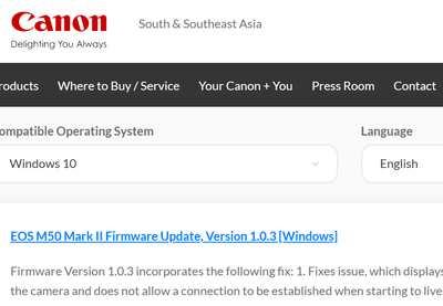

Hi Canon Community,
I recently purchased a Canon M50 Mark II and it comes with 1.0.4 firmware. I noticed that Canon US has up to the firmware 1.0.3. How it this possible? I did my research and it looks like that firmware exists in SouthEast Asia? I have heard that this happened to other people even when they purchased from a certified dealer. Please, anyone, I need help to make my camera work. It is not being read by my Mac M1. Can I downgrade to 1.0.3? How can I solve this issue, I will mainly use the camera for livestreaming, using it as a webcam. Please help. THANK YOU!

What Peter said was true. Canon might have released a newer FW on the device you purchased, nothing to be concerned about. This is normal.
Do not try to downgrade your FW, this could potentially brick your camera. Canon Asia only has v1.0.3 also.
You will not gain any functionality with FW v1.0.3. The issue you are describing probably lies with your MAC.
