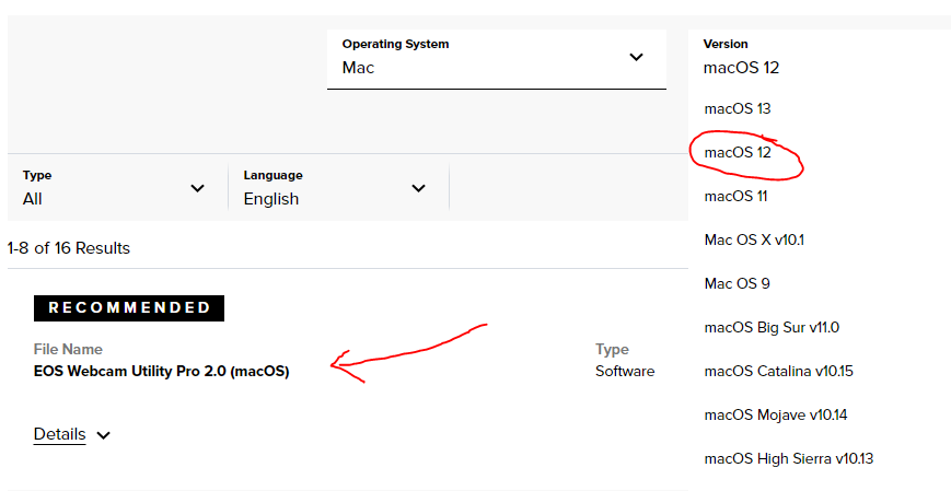

Have you installed version 2 of the EOS Webcam Utility? That's the only version that's compatible with M1 Mac. You will have to manually select macOS 12 if you're running macOS 13. You can get the software from HERE
