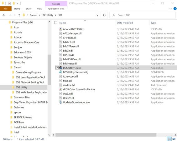

Try launching the EOS Utility 3.exe Windows File Explorer and see if that helps.

Can you post a screenshot of the logo of a computer that you see when connecting the camera? There are 2 different screens that appear when connecting using the EOS Utility. I assume you don't see the screen that shows only the camera back.
The first screen shows a computer and a laptop and is displayed by EOS Utility.exe. The second screen shows the back of a camera and is displayed by EOS Utility 3.exe. Are you seeing only the first or is the second screen displayed after a delay?
