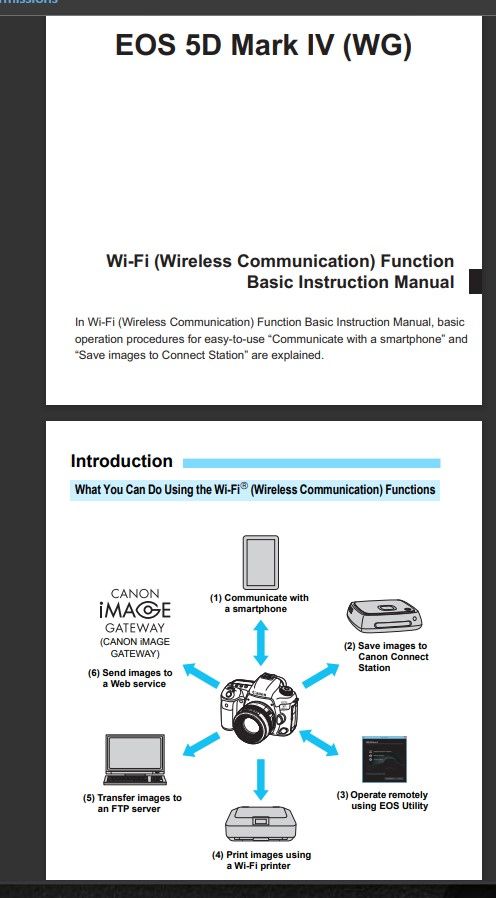

The 5D4 does not even have Wi-Fi.
02-01-2024 01:21 PM
It does.
02-01-2024 11:36 PM - edited 02-01-2024 11:37 PM
Ah, that’s correct. It lacks Bluetooth, which can automate Wi-Fi connections and configurations. My 5Dsr does not have it.
Make sure the camera is set for USB. It cannot switch between USB and wireless on its own.
