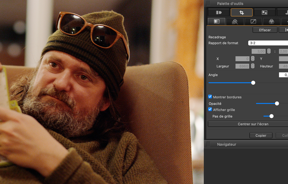

01-03-2025 07:32 PM
Hi!
I'm having exactly the same issue, on DPP 4.19.31 on my Mac M1. Before finishing the full processing, the picture is sharp and nice, then the process finish and it's blurry and like diffuse. Also I can see the difference exactly like you, by using the crop/rotate tab.
Did you found a solution since then?
Tomorrow I'm gonna try on a Windows computer to see if I have the same issue...
