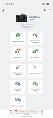

Anyone else getting this every two seconds while remote shooting?

I only have one phone, but I do have an RP I connect to as well. It was off at the time entirely. I also turned off my home wifi as to not let the phone auto-connect. I'm on an acre, so no one else in range, likely.

02-20-2026 06:01 PM
Thank you, I have a custom name for it for sure and it reads it just fine. The connection works well EXCEPT this notification comes up every 1-2 seconds during live shooting. It doesn't do it during viewing of the gallery. I have tried deleting and starting fresh, but it persists. It did this to me for my RP months ago as well, and then it stopped.
It's like something keeps pinging the app to make a new connection when I'm already connected.

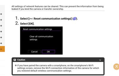

First thing to try. Take the flash trigger out of the equation. Please turn it off and remove it from the camera. Then retest. Remove the saved wireless profile for the camera too on your P9 in wi-fi. Result?
I'm glad you like your custom name (camera) but we have seen them cause issues before. I would delete the saved camera profile from the app as mentioned above, then reset the communication settings on the camera. This is on the Communication menu tab 4
https://cam.start.canon/en/C017/manual/html/UG-06_Network_0320.html
Once complete, re-pair and retest with default camera name. Hoping one of these two things helps🤞
