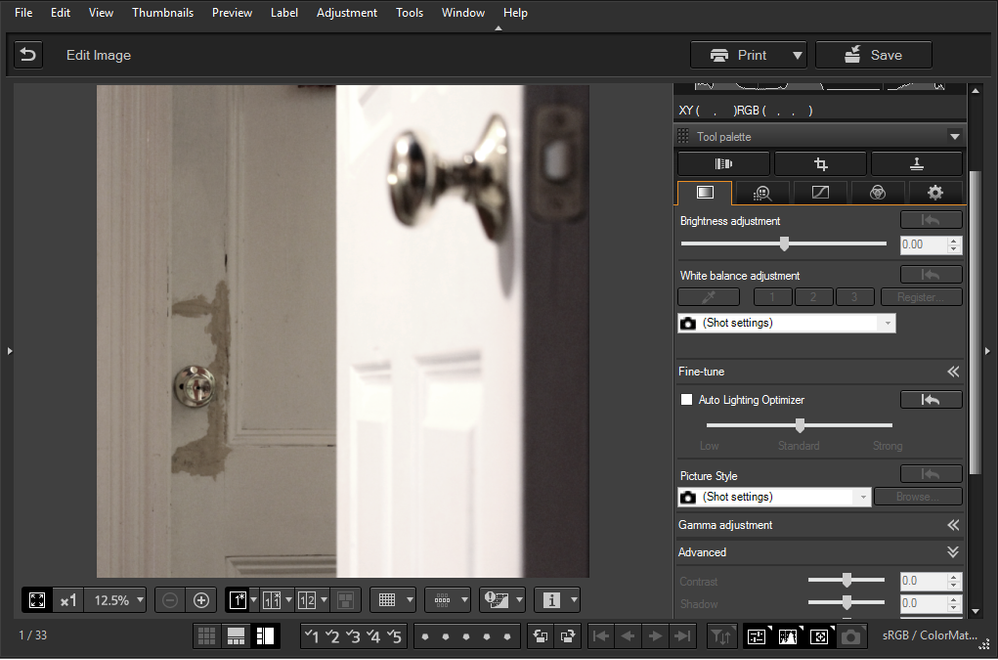

I *just* got my EOS Rebel T6 today. Google has not helped me figure out this problem. I'm sure it's something stupid simple, but I haven't found an answer.
I can crop and mess around with the color adjustments, but I cannot edit white balance, contrast, shadow, highlight....etc in DPP 4.5
I'm running windows 10 and don't have any other issues with the software. I've uninstalled and reinstalled.
There is a drop down menu under white balance and picture styles, but it's not active. It's stuck on (shot settings.)
I'm attaching a screen cap. Any help is appreciated! I'm going a bit crazy here.
1 ACCEPTED SOLUTION
The menu that you're in is intended for editing of RAW (.CR2) files. If you're editing a .JPG file, you need to be in the menu two tabs to the right (the icon that looks a bit like a graph). If that is what you're doing, and if you go to that menu, you'll probably start to see why we invariably recommend to the participants in this forum that they always shoot in RAW mode.
