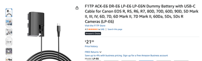

While doing astrophotography I do not use my standard camera batteries. So, while continuing looking for an alternate power source for my DSLR after my post, I found a solution using a USB C PD for my camera. I even have a battery for my electric heated jacket that will power the camera using this device.
I found on Amazon a way to power my DSLR via a USB C plug. I can eliminate the battery brick connection that plugs into a 110v electrical outlet. You can get cigarette plug power sources that have the female Type C USB plug; however, a cigarette Type C PD plug needs to be a PD30W.

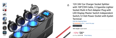

I previously purchased this 12v power hub that has one area for USB type plug ins with all four USB plugs complying with the PD requirement.
. I am making a 12v Marine Battery power station for my setup. One day I might go to a remote site that will not let me use my generator at night.
Two reviewers’ comments on the camera power device cable;
One important note is that it requires a USB-C power source that supports Power Delivery (PD). The system draws around 13W of power during use, so a standard 5V USB output is insufficient—using a proper PD-capable AC adapter or power bank is necessary for reliable operation.
Make sure to plug it into a non-data usb c port.

Not sure which camera you are using? For USB-C PD it's safe to go with a device rated at 9v/3A and 45w (minimum). Plus all that's been discussed. Cable must be PD rated, and so forth. This will future proof you for the foreseeable future. This works on my R5 C which is one of the more power hungry bodys, and allows 8k 60p with all lens features. All you need is a standard battery in the camera.

I am using the Canon EOS 60Da for astrophotography. The Amazon USB C PD rated cable, I am researching, states it is for my camera. The standard battery for the 60Da is LP-E6N @ 7.2v and the DR-E6 (substitute battery blank) list 8v - 3A from the AC/DC converter. I have been using the DR-E6 connected to the AC Adapter AC-E6 for a power source during astrophotography sessions for years. But I want to convert to using DC power via 12v cigarette plugs, that have USB power/charging plugs and not use AC/DC converters connected to my 12v battery or power reducer type regulators that I have to adjust or make.
