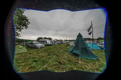

No you can't adapt crop sensor EF-S lenses. To a Full Frame, APS-H or 35mm AF SLR. EF-S lenses are designed to protrude into the camera body. The mirror in a Full Frame, APS-H or 35mm AF SLR would hit the rear lens element and serious damage the mirror. Even if you could use EF-S lenses on a FF/ 35mm camera you would see vignetting. The lens was designed to cover the APS-C image circle. So stick with Full Frame EF lenses. Don't attempt to use 3rd Party APS-C lenses either. These lenses will mount because they use the FF EF Mount. But they're designed to project an APS-C image circle. The picture below shows what happens when a crop only lens is used on a Full Frame camera.
