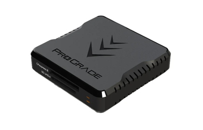

This is the card reader I used for my T6s, 6D2 and mobile devices.
I used it last night to copy lens firmware to the card in my R5 C. It doesn't claim to support UHS-II but it works fine, just more slowly. Its tiny too.
I use a ProGrade Reader for CFExpress B and SDXC-UHS-II normally.
