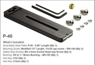

I went with a carbon fiber tripod with a published weight limit of 44 pounds and a total carrying weight of 3.1 pounds. It won’t arrive til the end of Jan 2025 so my final assessment of it is pending. Also opted to forego a center post. For the 200-800mm lens, I bit the bullet and got a Wimberly gimbal. My preference f
12-30-2024 11:07 AM
Don't forget to get the correct lens plate for the 200-800 tripod foot. They don't have one listed for the 200-800, so I got the one for the 800 5.6 - P-40. It has a screw adapter so you can attach it to the tripod foot with the standard screw and the larger screw or one or the other. Note that the tripod foot for the 200-800 has both sizes available to attach the ARCA Swiss plate 🙂
Newton
12-30-2024 12:32 PM
Yes…i am now faced with another big decision on quick release systems. Wimberly has a plate advertised for this lens at $100 on B&H….I do now own a Wimberly gimbal and my reason for buying a decent tripod and this gimbal is just to use the big lens. I prefer (i think) a clamp feature rather than a screw tightening mechanism…so i think i will ask the community a question focusing on systems. I rather liked the price and features of the Neewers…but do not think they are arca swiss types but since i have NO system now… i have no sunk costs in this kind of thing at this point. Want 3/8” for sure
12-30-2024 03:12 PM - edited 12-30-2024 03:17 PM
What you may be seeing for $100 is the AP-608, which is the entire lens foot assembly. Since the foot on the RF 200-800 isn't removable, you just need the P-40 quick release plate, which is $58. This plate attaches to the foot on the 200-800mm and you just leave it there, at least I do 🙂
Once the P-40 quick release plate is attached to the foot of the 200-800, you just slide it on the the gimbal. You can adjust balance and lock in the foot with the thumb screw on the Gimbal. The quick release plate has a downloadable PDF users manual that tells you how to use the various screws. Some are set screws to keep your lens from slipping too far.
Newton
12-30-2024 03:31 PM
Yep…i figured that out when i opened the box for the gimbal! Got the p50 which was what they recommended for the 200-800mm. Now i am looking at body plates as i do not always want to have the gimbal attached (or maybe i will - just thinking about weight)
