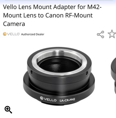

12-24-2025 09:17 AM - edited 12-24-2025 09:20 AM
I quick search shows that there T-mount to RF mount adapters from several manufacturers. This would be a far less costly approach than my previous suggestion of using a RF to EF adapter. This type is a direct connection to the scope.
The image is neither a suggestion or an endorsement. This model was at the top of my search list.
