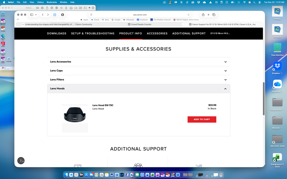

You do not haver the correct lens hood on the EF-S 10-18mm lens.
You can find the correct lens hood for any lens by going to the appropriate support site for the lens and reading the manual.

Thanks John
I have one in my kit bag so will swap it over now.
