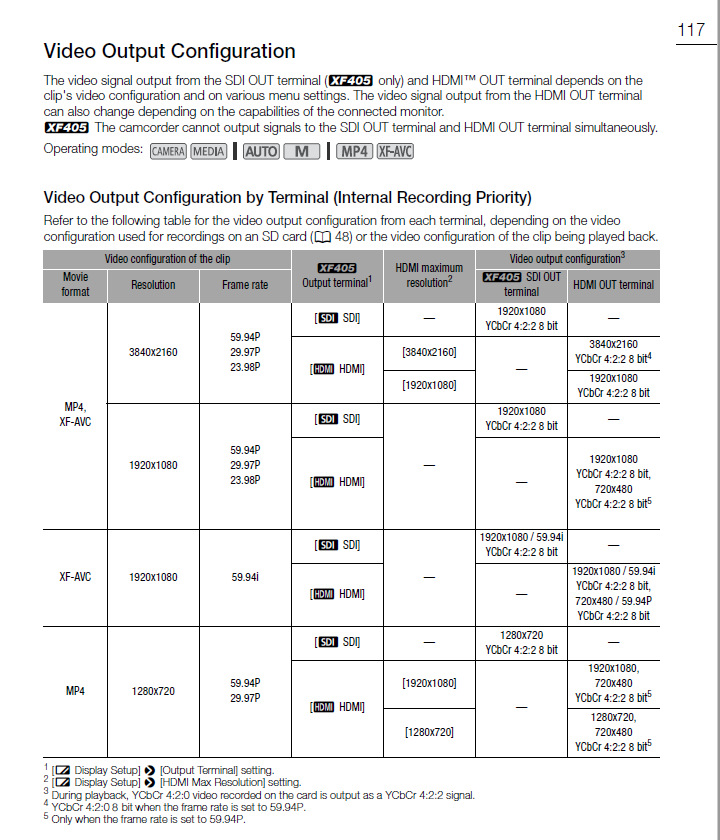

12-17-2021 12:46 AM - edited 12-17-2021 01:01 AM
It means that it is outputting an 8 bit YCbCr 4:2:2 signal.
User Manual (NTSC version), page 117:
