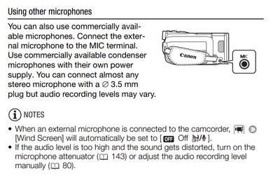

I have a Vixia HF S100 camcorder. When I record from my PA mixer into the mic input of the camera, the end result of the recording is distortion! I've tried everything I know and it is now up to a genius to help solve this. All help is greatly appreciated because I have another performance to record coming up soon. Thanks.
12-17-2022 05:12 PM
Greetings,
This is likely caused by the amplified output of the mixer. You can adjust the input using the in camera attenuator.
hfs10-s100-nim01-en.pdf (c-wss.com)
