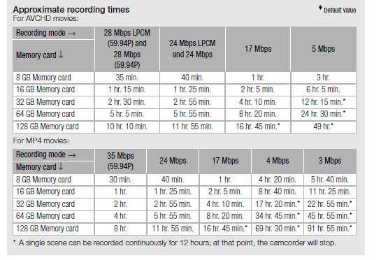

I don't know why it would do that. Page 44 In the User Manual:
Did it happen just the one time or does it happen everytime ?
Was this on battery power or using the DC power adapter ?
Was it connected to a LANC remote control and/or on-camera (field) monitor? Connections should always be made before the camcorder is powered on.
Have you tried changing the SD card ?

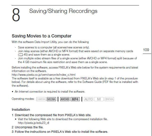

As for split mp4 files, the Pixela Data Import Utility will join them:
And on page 39
