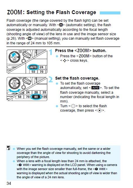

Most Canon Speedlites (the 470EX is one) will auto zoom to match the camera focal length.
John Hoffman
