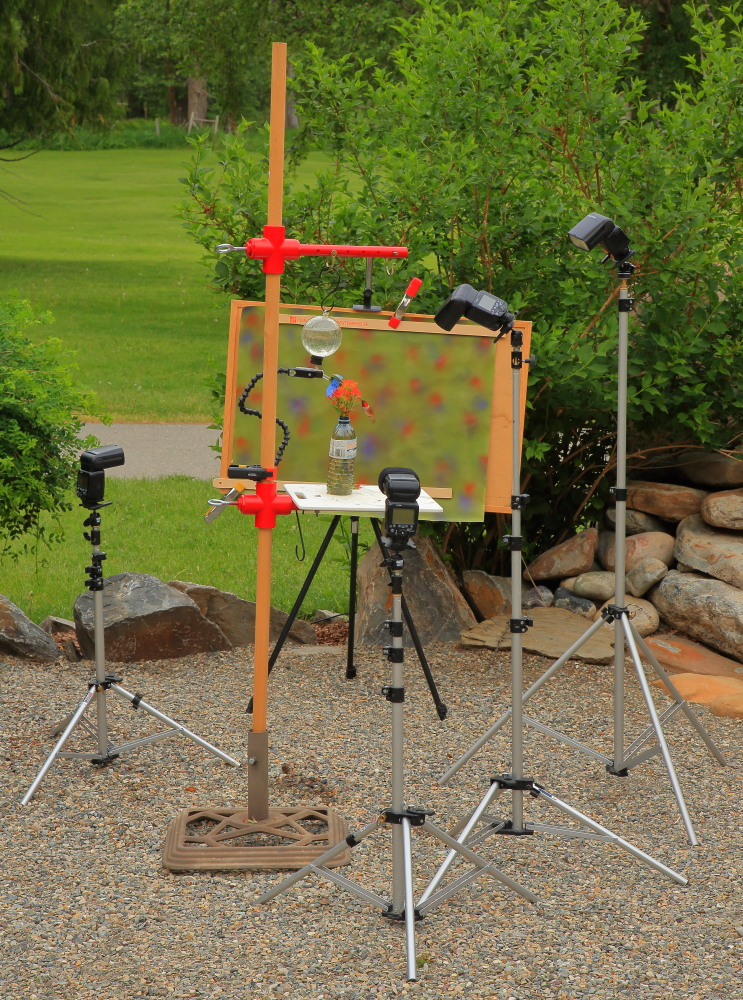

Here's a couple more images. Glad you like it! The male calliope's wings are blurry because I used a much longer flash duration at 1/4 power. In the flash station image, I am using the ST-E3-RT controller to fire the Speedlites.
John
