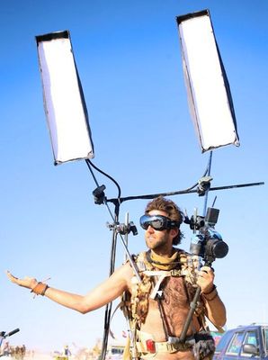

If I didn’t have an assistant to follow me around, and I was going to ComiCon, then I’d go big and make my own solo off-camera lighting suit (a la Eric Schwabel at Burning Man) only with a Comic based theme. I don’t know some sort of spider superhero?

I went to CC last year and I did see someone with a similar setup to the Eric Schwabel photo in your post 🙂 But for little o'l me, all I have is my camera and the off camera source 🙂
