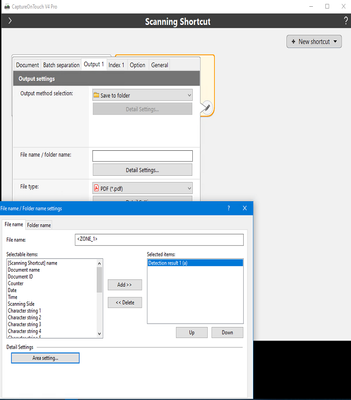

You can see below my configuration;
1) Barcode Separation settings
In Test, it recognizes the barcode normally
2) File name settings
I have left the name blank, and in the Details Settings I have configured to receive the barcode number as name by creating this Detection Result string.
Now, I face two issues;
1) When I try to scan some documents, and press finish to save it, it prompts an error message saying that the path is not valid. Nevertheless, it saves the file in the correct folder, it gives the name of the first document's barcode bit it doesn't do the searation.
2) In the configuration, in the File name settings I inserted something to test it (before I had it as blank), the error message didn't prompt and it did separate the documents. The problem here is that it didn't have the name I want (I need the file to have ONLY the number of the barcode as name), also it separated each page of the documents even those who had the same barcode.

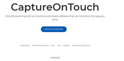

Of course, it was the first thing to consider! Unfortunately, the support in my country told me that they support only home products and not enterprise (!!!) and they do not know about CaptureOnTouch. Also, the link to "Request information" for the software in Canon's website, doesn't seem to work.
