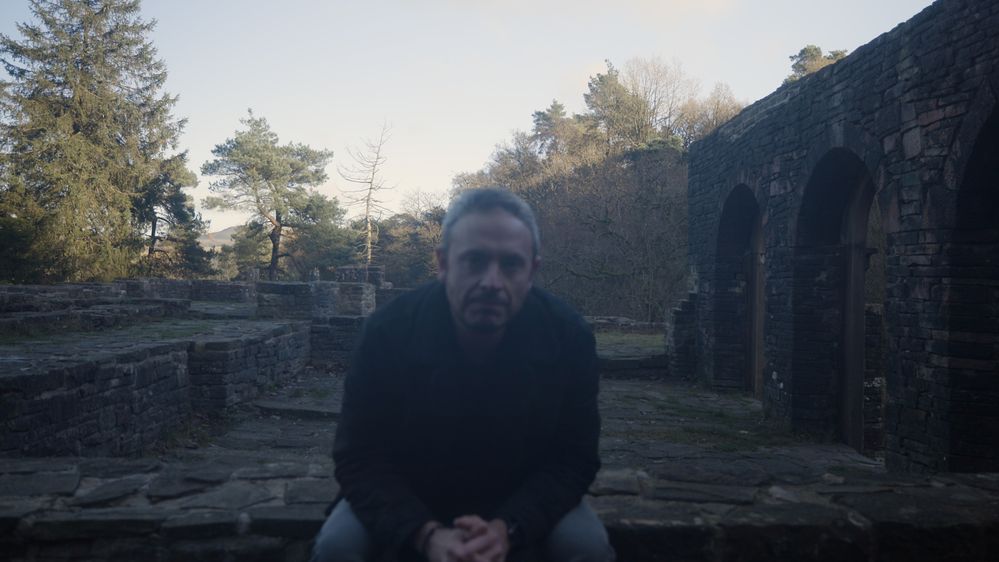

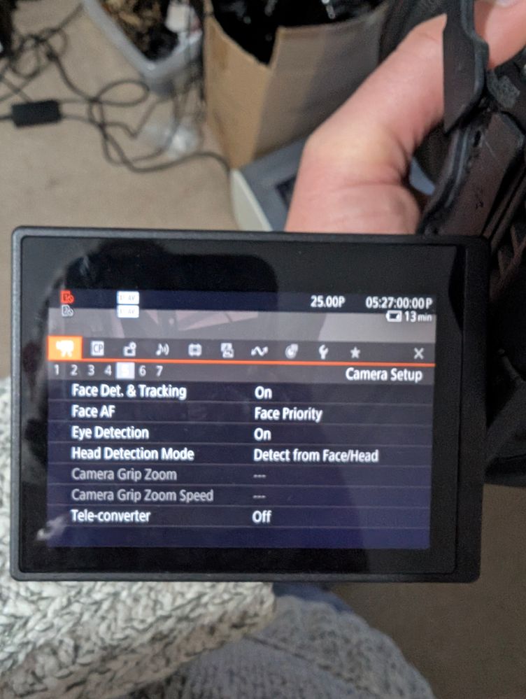

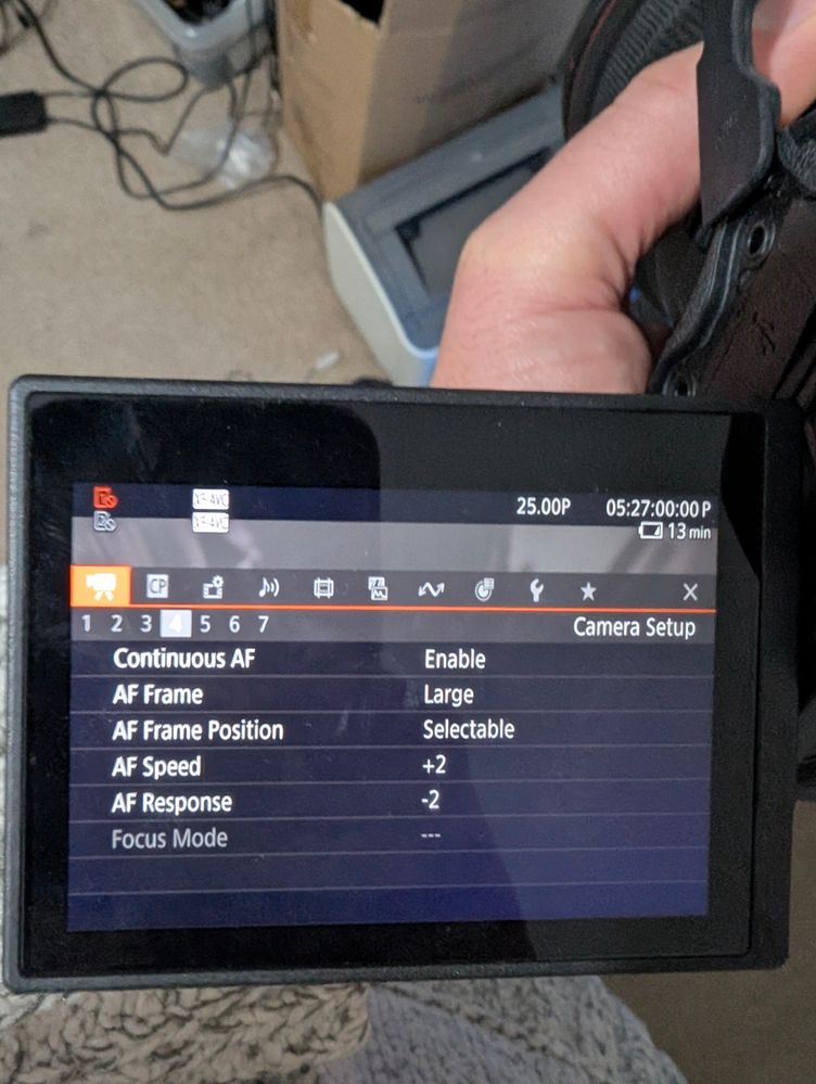

I was hoping someone might be able to help with an autofocus problem on the r5c. I'm sure it used to be fine, and is only happening more recently. But I can shoot several minutes of talking head video and it not focus. In this I'm using a canon rf 15 35mm f2.8 lens. But it happens with others. Settings attached. Many thanksPXL_20251117_173344687.jpg

Your video looks to be underexposed.

Try changing your AF Frame to small.
Are you tapping or using the joystick to select your subject?

Thanks, I'll try. I use neither as I'm filming myself talk. So I set up, hit record, sit and go.

Based on your description, it doesn't look like the camera is tracking properly. I'm sure there's nothing wrong with it. It's just going to be a matter of you getting it dialed in.
I'll provide detailed settings later today.
Here's what's missing
Since you are filming yourself, the camera has to be set so that it will track subjects as they exit and re-enter the frame (You).

I'm not surprised it won't focus on you .Like the location you are in you are severely under-exposed so the autofocus is focusing on the brightly lit trees in the background. This is the sort of thing that happens in low light with contrast based autofocus.

Agree with you about the underexposure I mentioned that in my first reply 😉
