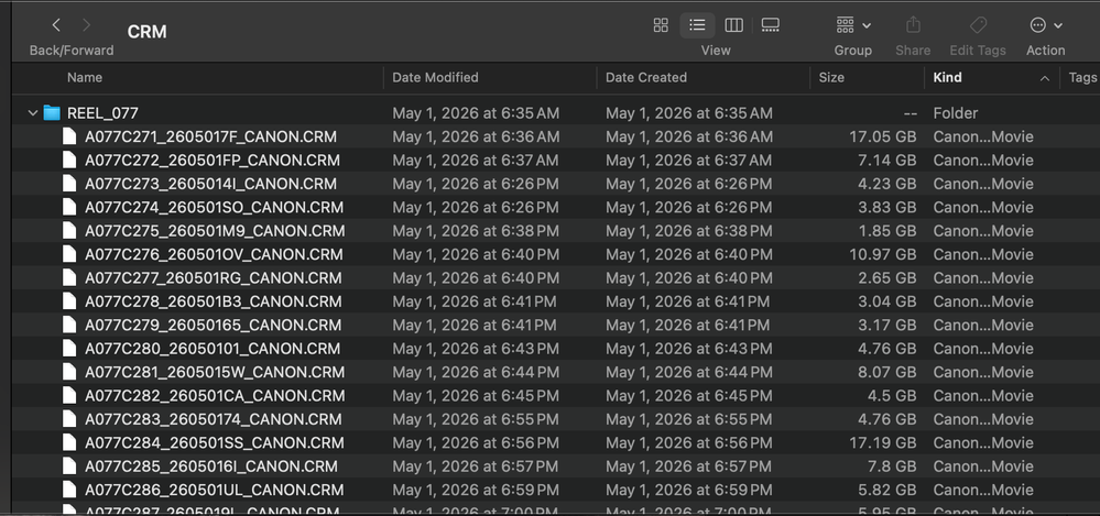

Thanks for the convo. On the external drive, the date and time created is correct on the CRM file. Date modified mathes the time I transferred the files from the card to the hard drive. If I copy the files back to a card from the hard drive, the date and time created are retained on the CRM file, but at the same time it creates a XML file and that created date and time is changed to when it was transferred (to today's date and time). When I then use CRD to import the clip from the card, the date and time are changed to today. Any additional ideas? To me--this means that something is going on in the CRD process because I can see the original date and time shot on the CRM file. Thanks!

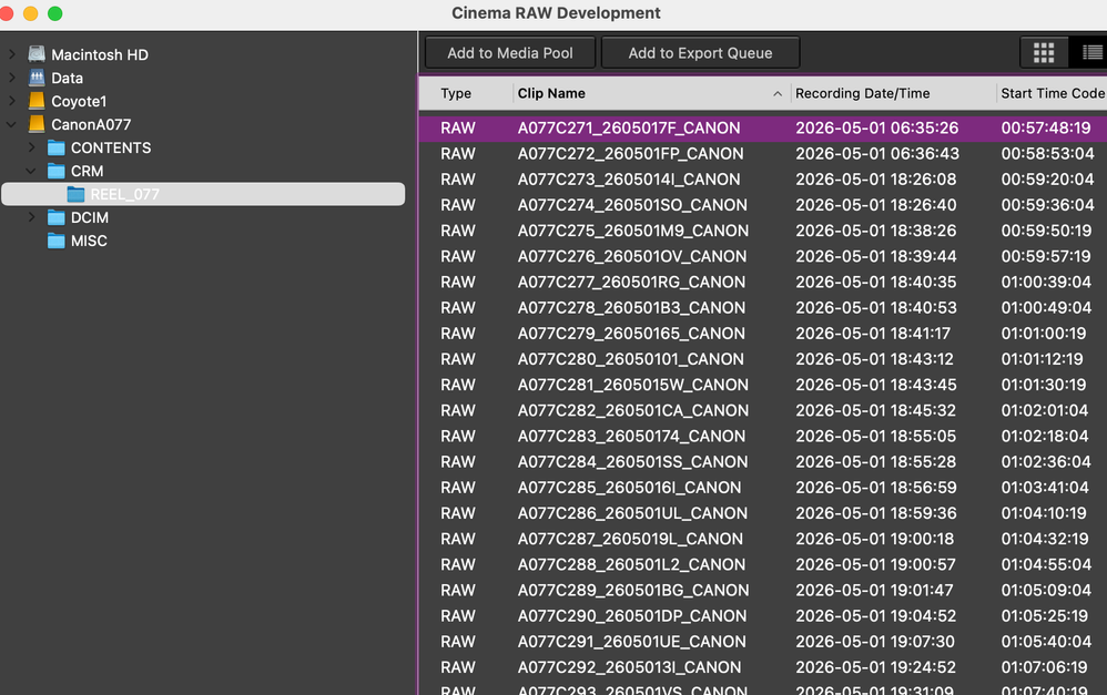

So I'll ask in a different way: where are the settings in Canon Cinema Raw Development that allow me to keep the date and time recorded? Currently, when I import a clip, that information is not retained.
Inside the CRD<Settings ?
And / or in Export<Export configuration.
What needs changed? Thanks!
I don't have a C500, and I've never used CRD before (I just load RAW files into Resolve), but I've had a go at testing this with my C80, and here are my results.
In CRD, in the menus, check "View -> Clip Information". Select your clip. Under "Recording Date/Time", it shows the date/time the clip was actually recorded. See first screenshot.
Note that the "Recording Date/Time" is 08:51:56, whereas the Window "date modified" for that file (second screenshot) is 08:52.  That's when the file was last written to, as opposed to when you pressed record.
The good news here is that this is the recording date/time stored as meta-data inside the file, by the camera, so it isn't fragile like the operating system's meta-data. The bad news is that it's up to the camera to store this, and not all cameras do. Clearly the C80 does; as for the C500, I have no idea. If the camera doesn't save that information, then it's not there, and I don't know what else to tell you.

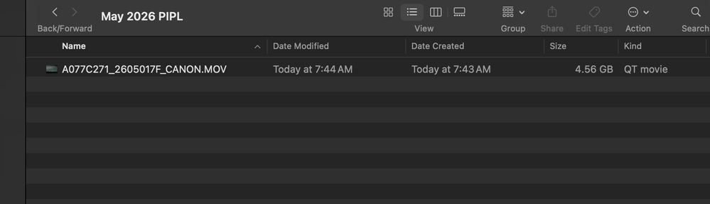

Yes the original dates and times are on the media when it is on the camera card. The camera most certainly records date and time. (see 'inside card' attachment, and 'inside CRD'). But when I process the clip in CRD, the resulting file does not have matching dates and times, it is the date and time that I processed the clip (see 'in finder after export).
This is a change from what happened previously on import. I have been shooting with this camera for many years and those dates were always correct in the past. I wish Canon would fix this.

But if I understand your latest post, it seems like you're trying to convert RAW files to MOV (with some video format inside the MOV container), and you want the MOV files to inherit the shooting date of the original RAW files. Is that correct?  (That wasn't abundantly clear before.)
And it seems you're looking at the "Date Created" and "Date Modified" on the resulting MOV files.
So, as I've been trying to explain, thoise fields are the operating system's meta-data for those files. This operating system's meta-data is unreliable and will not give you what you want. It is there for the operating system's benefit, not yours. And, in particular, on generated MOV files, it is always going to show the date/time when those files were created -- in other words, when you exported them from CRD.
I know you said "This is a change from what happened previously on import", but I don't understand how that can be. Maybe you were looking at something different?  (I'm assuming you mean "on export", not "on import".)
It is possible that CRD could copy the recording date/time from the original RAW files to the media meta-data inside the MOV files. This would give you what you want. But you're not going to see that meta-data in Finder -- you will need to open the files in a video eitor to see it. I can't try this, because I can't get CRD to create a MOV file, only DPX (I'm on a Windows system).
So, if you open the MOV files in your editor, there's a chance -- a slim chance -- that if you dig through the media meta-data on those files, you might find what you need. Otherwise, I don't know what to say.
