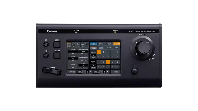

Hello, have a new setup of two CR N300s using ethernet / NDI through a switch with a RC IP100 and OBS. Issue I'm having is while panning the cameras using the joystick on the IP100 after letting go of the joystick to stop the pan, the cameras continue to pan for a little bit before stopping. Instead of my subject being centered in the shot where I stop the pan they are pushed off to the sides of the frame. It's like there is a delay in the controller telling the camera to stop panning. The amount of extra pan increases as the camera move speed increases. So a quick pan will over shoot more than a slow pan. It does this in the web browser window for the camera as well as the image in OBS. Is there a setting somewhere to fix this?

Receiving a set of CR-N300’s and RC-IP100 this week and testing it’s functionality I also noticed this overshoot. I think it has nothing to do with a bad or lagging network connection despite the product experts answer as I used a simple setup with only few devices connected to the network and everything working fine otherwise. I did find out there was a setting I believe it’s called PT acceleration that can be set to small, medium, big that changes this smoothing out of abrupt controller input changes and thus overshoot. I suggest you try this setting first. Best Regards from the Netherlands.
