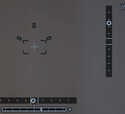

06-06-2022 02:36 AM
Greetings,
Remember I'm weeks behind on this. Have you seen the electronic level? Has tilt, roll and Tilt and Roll.
These display on the HDMI out (OSD) as well. Cool for keeping your horizon in perspective.
~R5 C (1.0.9.1) ~RF Trinity, ~RF 100 Macro, ~RF 100~400, ~RF 100~500, ~RF 200-800 +RF 1.4x TC, BG-R10, 430EX III-RT ~DxO PhotoLab Elite ~DaVinci Resolve Studio ~ImageClass MF644Cdw/MF656Cdw ~Pixel 8 ~CarePaks Are Worth It
06-06-2022 11:25 AM - edited 06-06-2022 11:26 AM
Hi Rick,
The electronic level is a nice carryover from stills cameras, but I have found them—in other cameras—to be unreliable, and had switched a longtime ago to using a grid overlay that presents no variability in accuracy.
I'm sure that you've seen my post about the audio menus. It seems that we are pretty much on our own, unless enough of us chime in with complaints on this site's 'feedback' option. That said, Canon does have an external microphone—DM-E1D Directional Stereo Microphone—listed, but which is currently unavailable anywhere I'd searched. I wonder if the R5c's audio menus are tied to this mic, since the mic attaches to the multifunction shoe? We'll have to wait until it starts shipping to answer that question. But no matter whether it does or does not bring the menus to life, there still is no option to defeat the internal mic in the menus.
