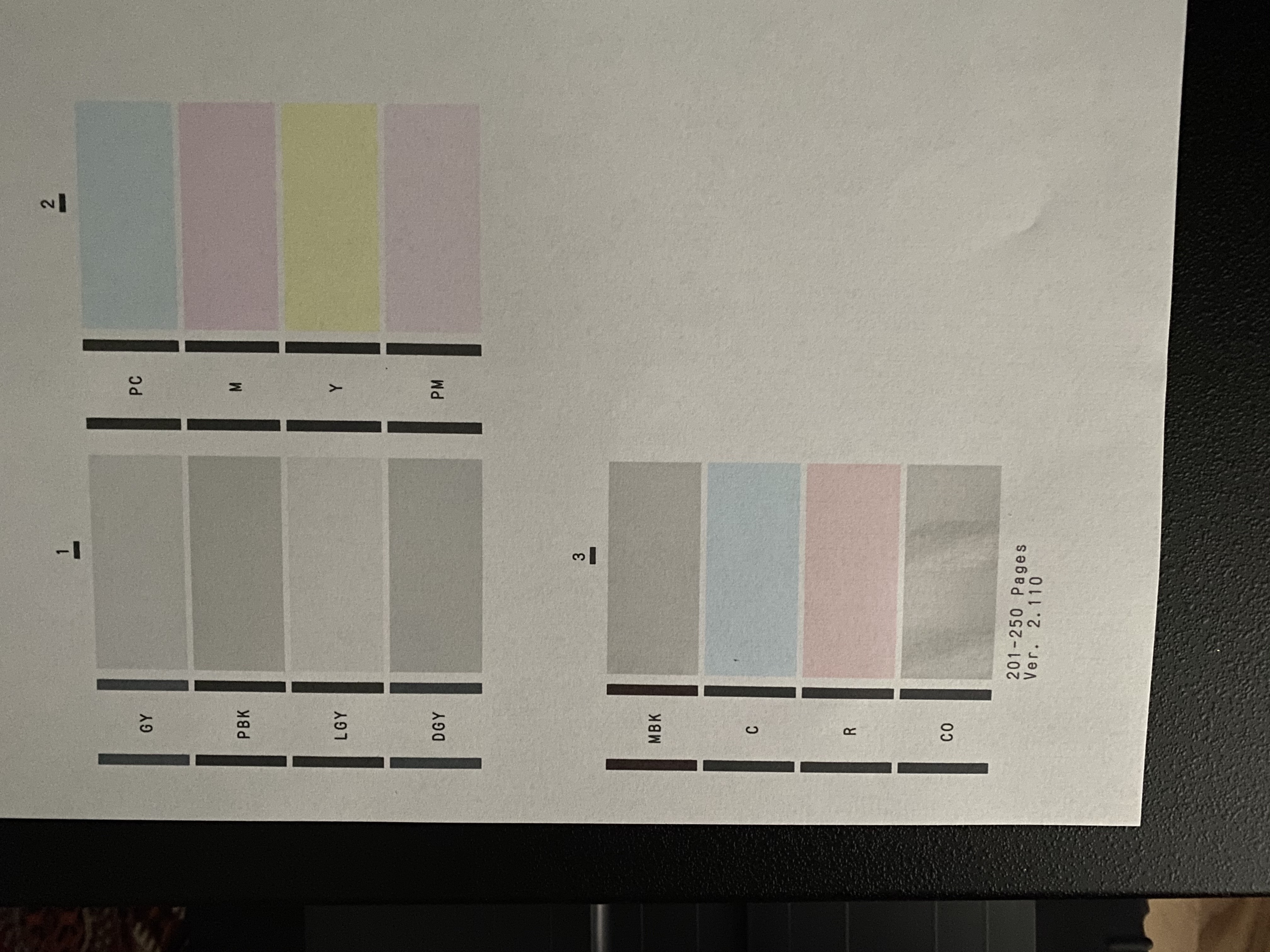

Hello.
Try printing a new photo.  When the fading issue occurs, immediately print a nozzle check pattern on plain paper and provide a sample of the results.  Details about how to print the pattern can be found at this link.

There is no horizontal banding in the print, although the darker vertical bars in the CO patch are lighter than shown on the Canon site.  Also, the problem doesn't exist when I print at letter size and happens on every 13 x 19 print.  Also, the banding at the end of the print is always in the same place.  The rest of the print is fine.IMG_2823.jpeg

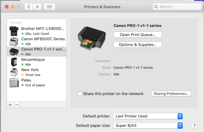

When you go to System Preferences->Printers & Scanners what do you see for your printer. AirPrint or IJ Series?

Re: Pro-1 Doesn't finish printing in A3 +
Neither.  I am connected to a hardwired network and it lists the printer as Canon Pro-1 v1-1 series.  I will attach a screen shot.Screen Shot 2020-03-25 at 9.18.20 AM.png
Honored Contributor
Posts: 7,815
Registered: ‎11-13-2012
That looks correct. You should contact Canon tech support. In the US its 1-800-OK-CANON
