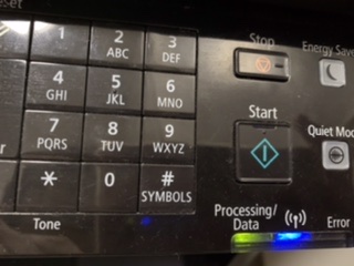

My mf217w used to work when i try to airprint from all my ios devices.
But now it stopped working, status kept showing "printing" forever, the processing/data kept blinking.
Ive checked the photocopying function still working.
firmware updated, initialised all settings, router reboot. Ive tried pretty much everything.
Is there any trick i can do? It seems so wasteful to replace a new one because of this stuipid issue. Every function works like a charm except the wireless printing, which happens to be necessary for me.
