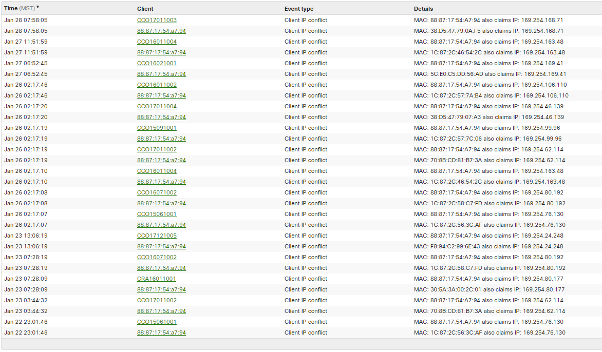

So I am still not understanding something here: You are saying that some other device is trying to claim the static IP Address that we have assigned to the printer and this is triggering the printer(or my server) to say that the MAC Address of the printer is active on mutliple APIPA addresses at the same time?
As further clarification and to reiterate my previous posts,
1) The printer (whether static IP, DHCP Reservation, non-reservation DHCP, different static IP Address for the same network) reports that there is a conflict on an APIPA Address only.
2) We have no other devices using the IP Address that the printer is using (when the printer is disconnected from the network nothing responds for that IP and we do not get the conflicts).
3) As this Screenshot from our Meraki Event logs shows, the printer will conflict with 7 different APIPA Addresses in the same minute, sometimes the conflict will report 2 different IP Addresses in the same second.
4) A device outside of our network could not possibly influence my server, firewall, or the printer to think that the assigned IP Address is being used, especially since my firewall does not allow unsolicited traffic from outsite of the network to communicate to devices on the network.
5) All of the conflicts being reported are for APIPA Addresses when a workstation is powered on and has not received a valid IP from our DHCP server. The conflict stops when the workstation no longer is using the APIPA range as it received a valid IP from DHCP.
6) DHCP Range is not issuing addresses in the range that the printer is assigned a static IP Address in. our printer is assigned a static LAN IP at .31 within our LAN and the DHCP Scope is only handing addresses from .100-.200.
You mentioned that to correct the problem we would need to go over the settings on the network server (Listed above), in our Firewall (the firewall is the one reporting the conflicts and we have submitted a feature request to let us exclude the APIPA addresses from reporting and the firewall does not play a role in assigning addresses to client devices), and we have verified that there are no other devices trying to use the static IP assigned to the printer (by disconnecting the printer, changing the address and the way it is assigned). All to no effect on the issue at hand.
What seems to be the issue from our perspective is that the Canon printer is continually cycling through the IP range of the APIPA IP Scope (or claiming the entire range), despite having a valid static IP address that it can and does communicate on. When any other device connects to the network without an IP Address already for the LAN it self assigns an APIPA address until it gets the DHCP address it requested (less than a second for the response).
