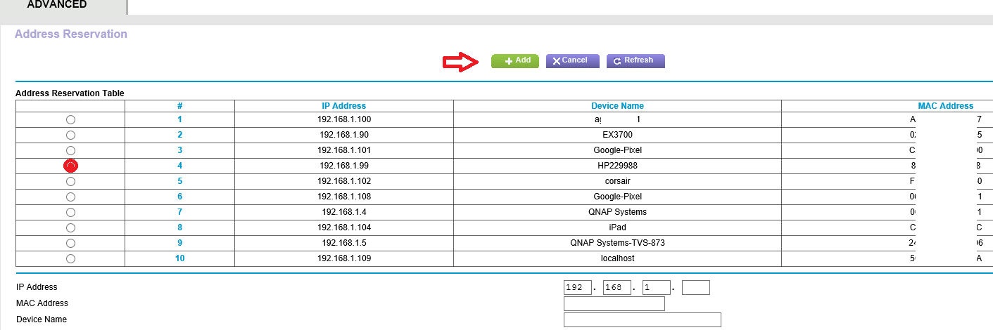

Easiest way:
See page 95. Advanced tab > Set Up > LAN setup
Note:
Image 1

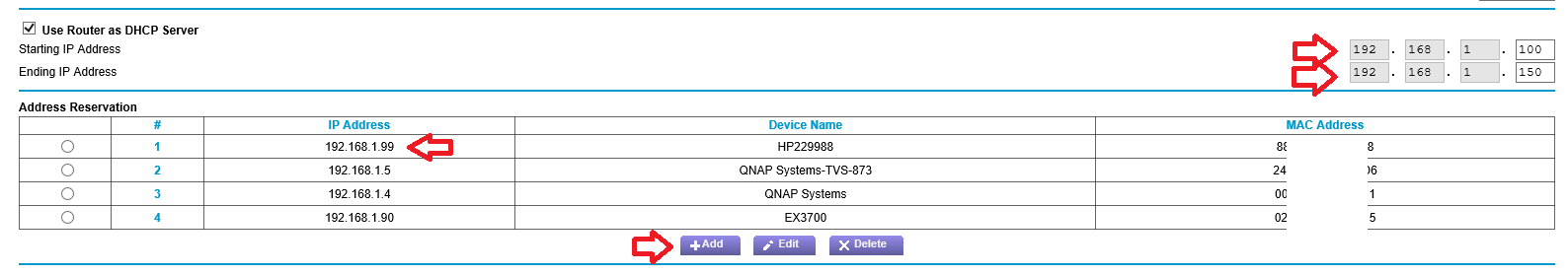

Notice I have specified a DHCP pool range of 192.168.100 ~ 192.168.150
This leaves the IPs from 192.168.1..2 ~ 192.168.1.99 and 192.168.1.151 ~ 192.168.1.254 to use as I see fit. My R8000P will not assign IPs to devices in either of these ranges.
My DHCP pool resides in the middle. You can set yours as you wish. Above, below, wherever.
Click the "+Add" button
Image 2
Find your printer in the list of devices, select the radio button and press "+Add". This will save the assignment. For good measure, power cycle your printer. This will ensure the router assigns the IP address you have reservered for it.
Moving forward. Printer will always get the same IP. No more "moving target, even if you shut it off for weeks, your router will never give its IP to another device.
